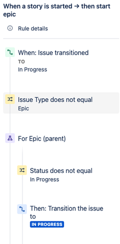

Mikael Sandberg
November 5, 2021
Your automation should look something like this:
