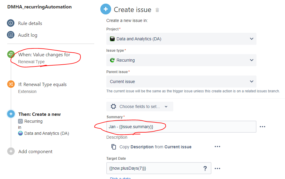

Hi,
I am working now on creating subtasks based on one custom field change. I am able to make this work but the problem is troubling adding  "prefix - Summary" on subtask during the creation.
I tried writting the text as "Jan - {{issue.summary}}"
and "Jan - {{issue.parent.summary}}"
Both did not work. Second one updating the Task summary. But I need it for Subtask.
Any advice?

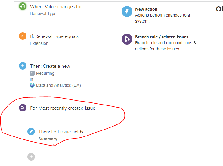

Omprakash Thamsetty
May 23, 2022
Look like I figured it out. I used most recently created action

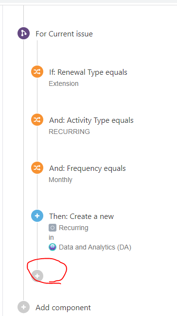

Omprakash Thamsetty
May 23, 2022
Hi @Ismael Jimoh
Looks like I don't have the Branch rule/ Related issue option in IF block. I tried Branch rule/Related issue on Main branch but I have added If condition to check some of the field values to trigger create subtask as shown in below pic.
Do you have any idea how I can handle Branch rule/related issues in IF block? Or any otherway I can change the subtask summary which we create in IF block?
