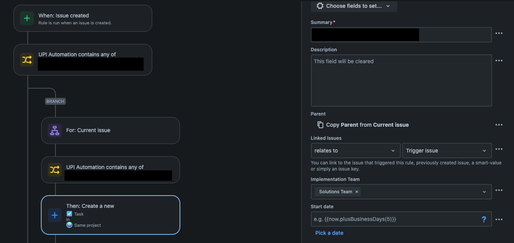

I am working on an automation to create some new issues that link to the trigger issue. But when the automation runs I get this error.
"Unknown fields set during create, they may be unavailable for the project/type. Check your custom field configuration. Fields ignored -
Linked Issues (issuelinks)"
I have Linked Issues set to Trigger Issue, I have also tried with {{triggerIssue.key}} but I get the same error.
Anyone seen the same or know what I am doing wrong?

Hello @Ralph Casafrancisco
If you create the same type of issue in the same project manually through the UI, do you see the option to add a Linked Issue in the Create Issue dialog?
The Linked Issues field has to be available in the Create Issue dialog for that issue type in that project in order for you to be able to set it within the automation rule.

November 16, 2023
Ah that was it, I had missed adding it on that one Issue type. Thanks Trudy!
