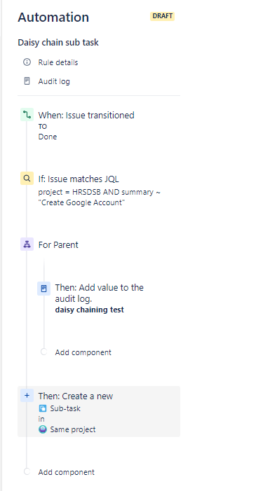

I'm noticing a few problems in the rule you posted on 6-Mar-2022.
  • Early in the rule, you should probably use a conditional to check the Issue Type. You can only create Subtasks on standard issue types (e.g. Story, Task, etc). Based on the trigger, this rule will run whenever any issue of ANY type is created in the project (e.g. Epic, Story).  It sounds like you want this rule to continue only when a Subtask is created. Admittedly, the JQL check against the Summary will help, but it's a loose check. Adding that conditional will prevent certain errors in your rule.
  • The "Create new subtask" action is outside of the "For Parent" branch, but I think you want it to execute inside that branch. Then the "current issue" will be changed to the parent of the triggering Subtask, and that's the context you need when creating your additional Subtask.
Hope that helps!

I thought I had tried moving the action under that side of the branch but you were right and it worked!

Bit of a delay but still need to work this out. My automation looks like this

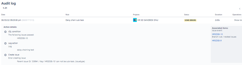

Then the log gives me this
I want to create a sub-task, it works fine for task but gives the issue in the logs above when I try and do it for sub-task

Thanks for the screenshot.  I can see that the action of the automation rule is attempting to create a subtask on an existing subtask, which is why it's failing to work.
Try instead to place that "Then: Create a new" subtask action so that it's nested under the "For Parent" branch instead.  This should let that issue be created as a subtask of that parent issue then.
