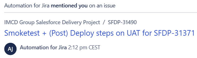

What I can tell is that users are receiving Email notifications from the Automation User (as the Automation User is used for that).
It is exactly as mentioned, the User is mentioned in the Parent in the description field, cloning that field to a new story, and keeps sending those email notifications (also ring bells in JIRA itself).
