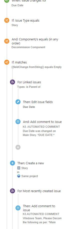

I hope i explain this right...
I have automation that on MAIN story if due date changes it updates the child with due date.
Then creates another story.
I need THAT story to update the trigger story (add comment) So, far I can only get up to Parent of.
Automation rule 1: Story A auto creates story B, based on component.
Automation 2: Trigger: If due date is added to Story A. Update Story B (with due date) - working
Then create Story C. - working
Then update Story B (comment) - working
Then update Story A (comment) - cant get working
I was hoping to insert a branch Rule for trigger issue. All there is is parent. Which basically goes up to Story B.

I tried moving it out. Still does not update the trigger.
I have to be missing something...
Lets try this again...
Story A is created, it auto creates story B.
Story A gets a due date, which updates Story B's due date.
(Would like a comment on Story A - that due date was update on Story B)
THEN it creates Story C.
(Would like a comment on Story A, that Story C was created.)
Then create Story D
(Would like a comment on Story A, that Story D was created.)
         Then Create Story E as child of Story D
(Would like a comment on Story A, that Story E was created.)
I think i am over complicating things...

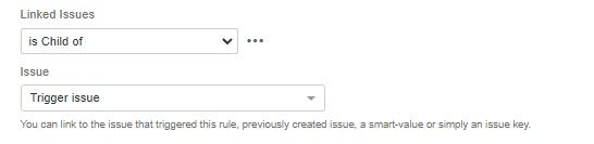

How are Story A and Story B related?  Are they connected with issue links, or something else?
Laura Hanna
December 19, 2023
When I create Story A, it creates Story B. with...
Choose fields to set...
I choose "Linked Issues"  Is Child of... Trigger Issue.
Bill Sheboy
December 19, 2023
Great; that helps!  And so I would expect your two rules to look like this:
Rule 1
  • trigger: issue created
  • action: re-fetch issue (This helps prevent timing problems when using the Issue Created trigger.)
  • action: create issue, linking it to the trigger issue as you show
Rule 2
  • trigger: field value changes for Due Date (this is Story A)
  • condition: issue type is Story
  • condition: any other conditions you needed...
  • branch: to linked issue of link type is Child of  (this is Story B)
    • action: edit issue, copying the Due Date from the trigger issue
  • action: comment on trigger issue, referencing that linked issue, Story B:
    • {{#issue.issueLinks}}{{#if(equals(type.name.toLowerCase(),"is parent of"))}}{{inwardIssue.key}}, {{/}}{{/}}
  • action: create Story C
  • action: comment on trigger issue, referencing {{createdIssue.key}} for the most recently created one
  • action: create Story D
  • action: create Story E
Please check all of the link types as I may have them incorrect for your situation.

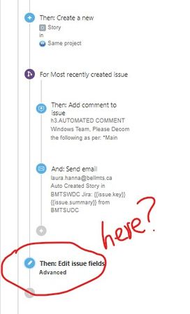

I am sorry I am really struggling to understand... My apologies. But, I am new to this. I have been scratching my head on where to enter that action...
But, I have no idea how to add comment on trigger?
There is no field for comment...
Please dont give up on me. I am here for the long haul and would really like to get this working...
Bill Sheboy
December 21, 2023
Going back to the beginning, you described adding a comment to Story A when the Due Date was changed in Story B to match.
That expression I provided will provide the issue key for Story B for your comment.  There was no other purpose for it, and so it is not used in the edit issue action.
