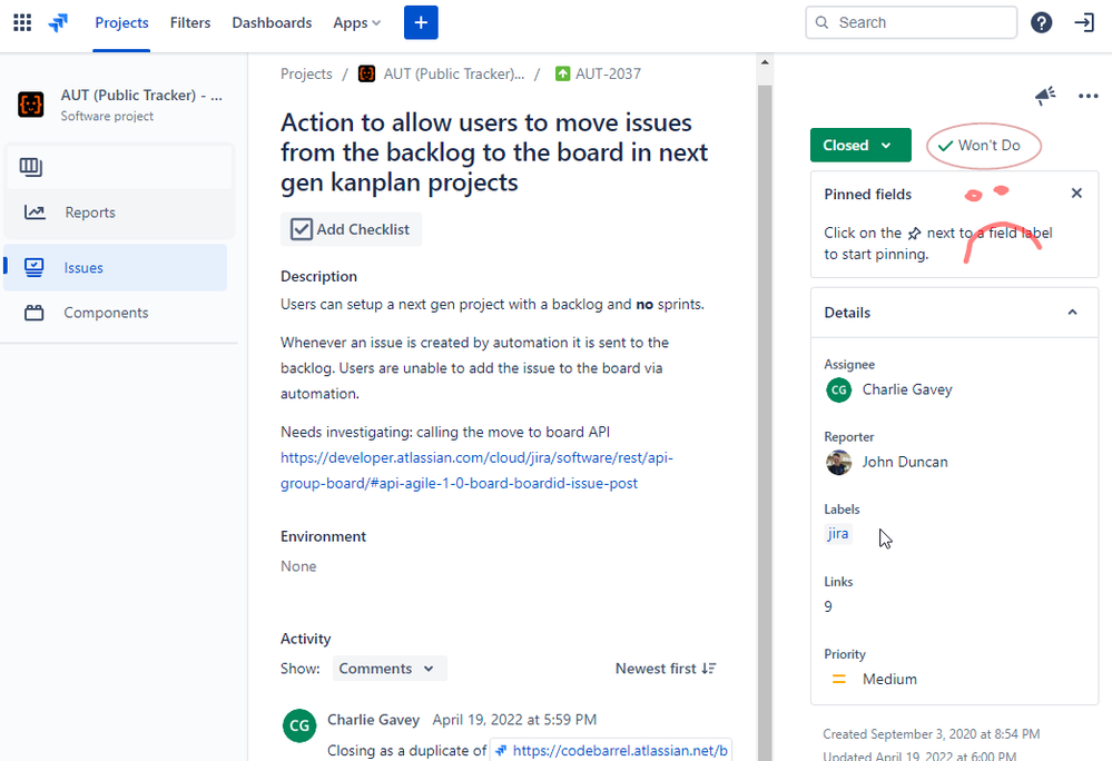

It's marked as a won't do. We're not going to get this functionality.
https://codebarrel.atlassian.net/browse/AUT-2037

If you look at the Comments you'll see that they closed it as a duplicate of
https://codebarrel.atlassian.net/browse/AUT-919
which is still open. And the issue is also tracked here

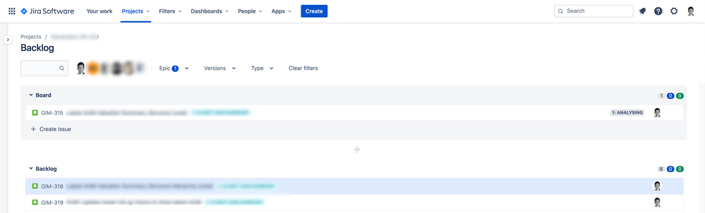

I don't work as much in next gen projects.
I've just set up one as an experiment and I don't see a Backlog option on it. Can you provide a screen image of what you're seeing showing the issue in the 'Backlog' but not on the board?
@Trudy Claspill : No worries - this is my first next-gen project and finding about all their idiosyncrasies.
