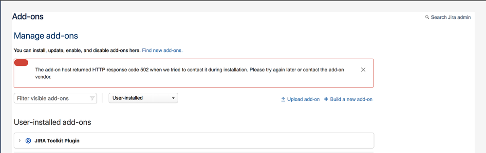

We are running an addon on an express server that is very similar to the code found here. Except, instead of serving up handlebars files, we are running a React app.
Locally, we can upload our app using ngrok just fine. When we run it on our production servers however, we get errors. Initially we were getting a 404 error when we attempted an upload. This was fixed when we added a `POST` to the `/installed` route, following suggestions from this issue.
Unfortunately, after the 404 was fixed, we now get a 502 error when we try to upload our addon. Checking the traffic that's hitting our endpoint, I see a 200 from Atlassian hitting us at the `/atlassian-connect` endpoint, where we return our `atlassian-connect.json`. That is the only endpoint getting hit on our end and our server logs no errors. (See image below)
Again, if we run our app locally and use ngrok, none of these issues occur.
Relevant code below (with some values changed)

Chris Chuck
August 31, 2018
Nevermind, I forgot to change the my baseurl to the production url :(
