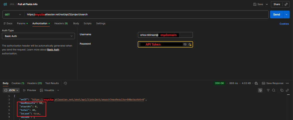

Right now, I'm stuck at the first API call. I've confirmed the call works just fine in postman, I get a list of projects back, no problem. The second API also works, but if I don't include the project ID, I have no way of telling what component belongs where - thus the automation.

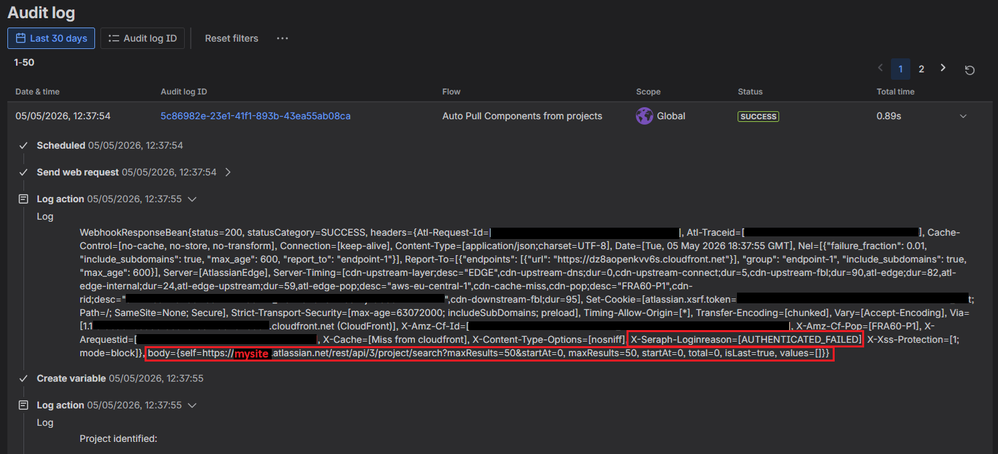

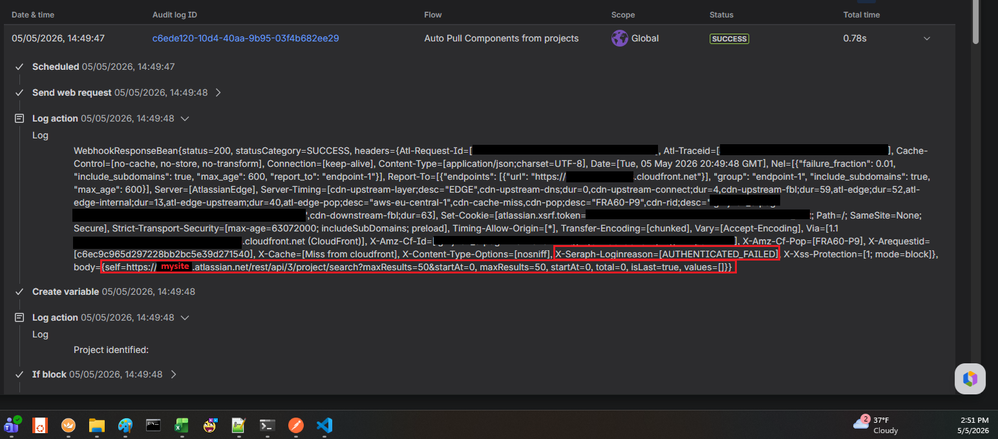

The automation is failing with this error noted in the webhookResponse:
X-Seraph-Loginreason=[AUTHENTICATED_FAILED]

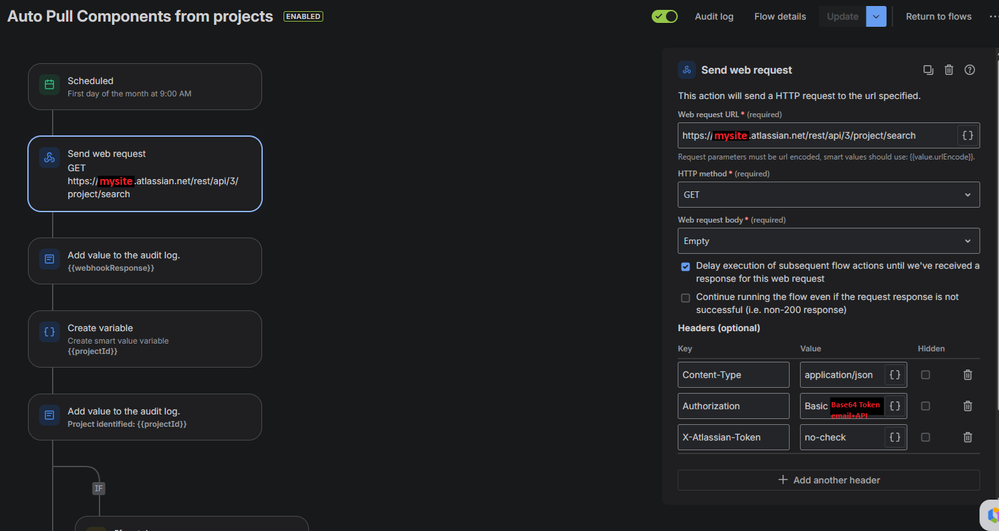

I've also tried adding in - recommended from the Atlassian AI:
 X-Atlassian-Tokenno-check
None of these modifications have worked or changed the output - other than just failing the test checks immediately vs just in the webhookResponse body.

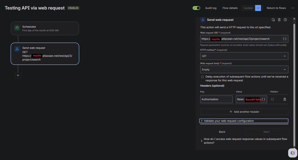

Here's the piece of the automation that's failing with the audit logs:
Here's the postman call using the basic auth creds:

Did you try only sending the Authorization header and encoding the value passed for the token as described in this article:

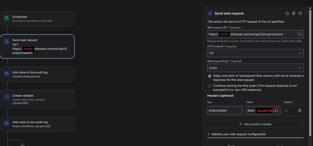

Erica Robinson
May 5, 2026
Hey @Bill Sheboy
I just tried that modification and the results were unfortunately same:
APICalls-ProjectCall_JustAuthToken-auditlogs.pngAPICalls-ProjectCall_JustAuthToken.png

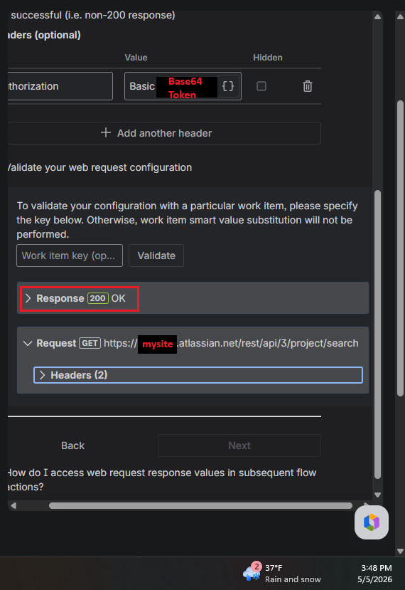

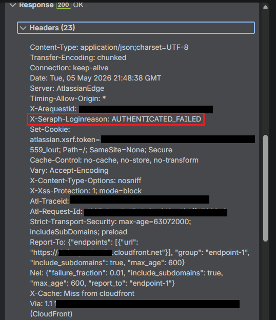

From inside the rule editor for the Send Web Request action, when you select the "Validate your web request configuration" at the bottom to run the call, what do you observe?
And, what are the permissions of the user for which the API token was created?

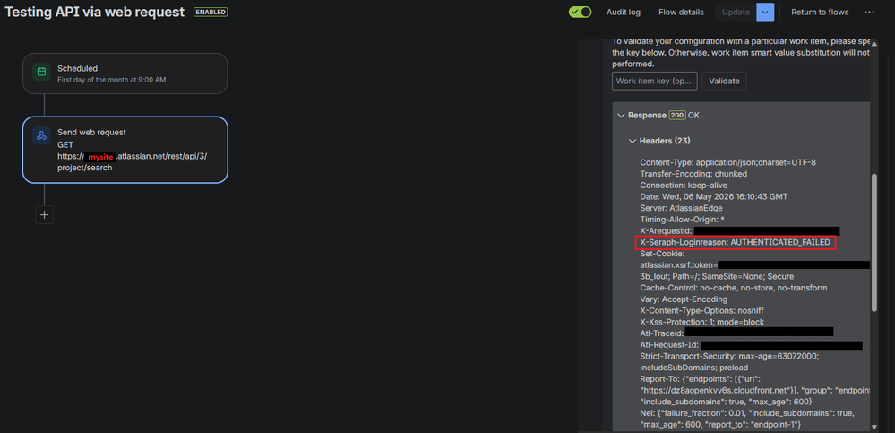

Erica Robinson
May 5, 2026

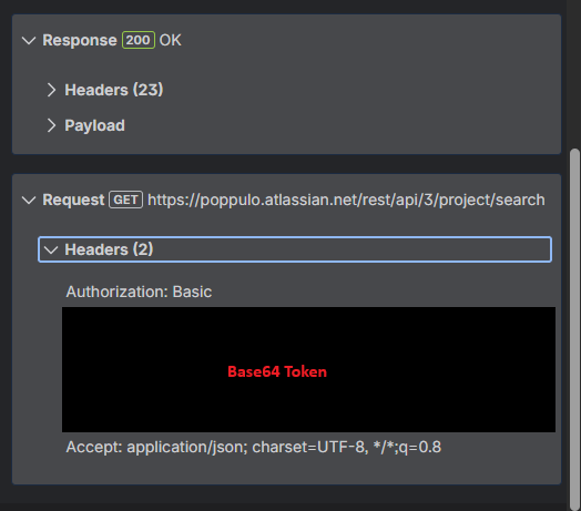

When I select the "Validate your web request configuration" it responds with a 200 success; however when I look at the headers it provides the auth failure there as well:
I can confirm that the request is also passing the base 64 token:
APICalls-ProjectCall_JustAuthToken-Validate_Headers.pngAPICalls-ProjectCall_JustAuthToken-Validate.png
Since it's my API key, it has Org Admin + Jira Admin permissions. I have access to everything in our Atlassian org.

Erica Robinson
May 6, 2026
Hey Bill,
I've following the steps you outlined and rebuilt the rule with just the webhook. Unfortunately it's still failing here :(
