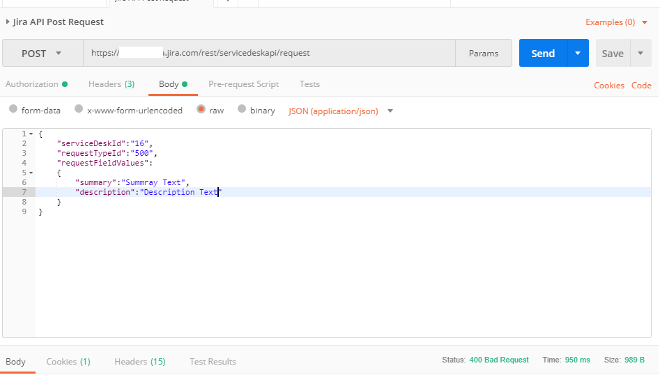

I have found the solution of my problem.
I have send
summary
description
but the Request Type has only the summary field and not the description field.
I have finally found the missing JSON Response. With Postman not with PowerShell.
I have saved the output and if you save the response it doesn't show up in the program.
I have to thanks @Alexey Matveev and @Payne for your ideas.

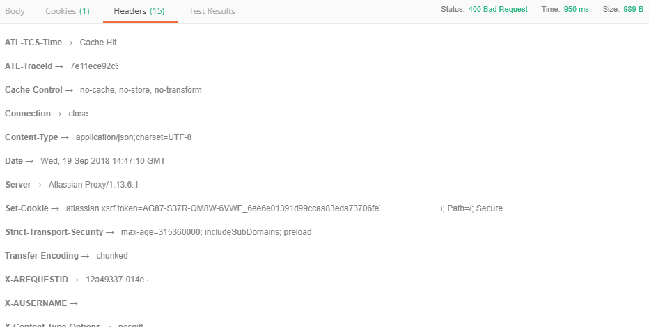

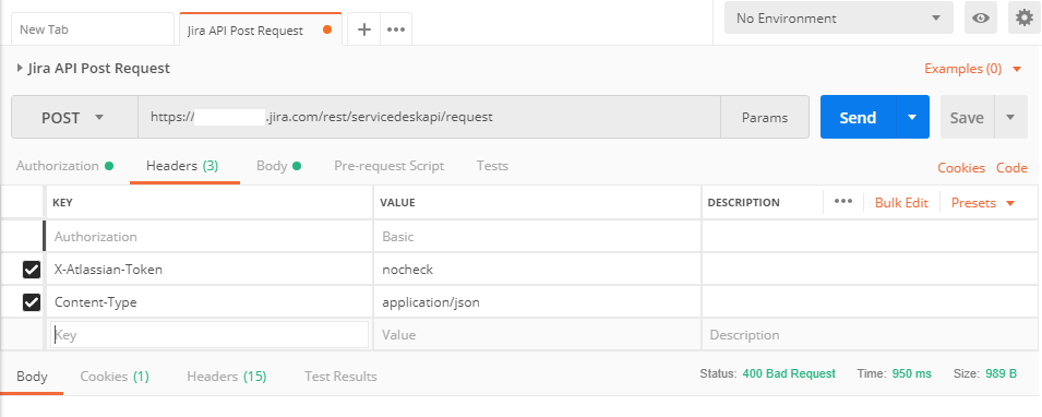

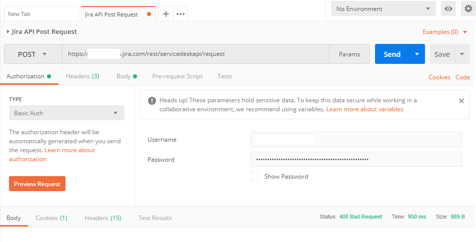

I have checked my Request with Postman and also with PowerShell "Invoke-WebRequest" Here are the specs
PowerShell:
$url = "https://x.jira.com/rest/servicedeskapi/request"
$header =  @{"Authorization" = "Basic -base64string-";"X-Atlassian-Token" = "nocheck"}
$body = @"
        "serviceDeskId":"16",
        "requestTypeId":"500",
        "requestFieldValues":{
            "summary":"Summary Text",
            "description":"Deesscription Text"
$res = Invoke-WebRequest -Uri $url -Method Post -Body $body -Headers $header -ContentType "application/json"
Write-Output $res.StatusCode
PowerShell Output:
Invoke-WebRequest : The remote server returned an error: (400) Bad Request.
In line:16 Character:8
+ $res = Invoke-WebRequest -Uri $url -Method Post -Body $body -Headers  ...
    + CategoryInfo          : InvalidOperation: (System.Net.HttpWebRequest:HttpWebRequest) [Invoke-WebRequ
   est], WebException
    + FullyQualifiedErrorId : WebCmdletWebResponseException,Microsoft.PowerShell.Commands.InvokeWebRequest
   Command
Postman:
Authentification:
Headers:
Request-Body:
Response:  (The Body is empty therefore I have the headers screenshotted)
This is all I get from the API
Best regards
Oliver Hart
