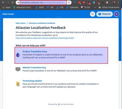

  1. Navigate to the translation Service Desk url: https://translation.atlassian.net/servicedesk/customer/portal/9
  2. Once there, you should be presented with the below screen:
  3. Click on the Link to sign up, in the next screen (below) provide the email address you use to log into here and click on "send link"
  4. You will then get an email with the link to sign-up. Follow the instructions in there and by doing this you should get access to the translation Service Desk.

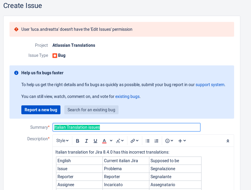

Hi Dario, I tried to insert the bug in Atlassian Translations project, but it seems that I don't have edit permission to do it.
I really would like to contribute or at least be updated, but it's not easy at all.

From the provided screenshot it looks like you are still trying to create the bug using Jira and that's why it is not working.
As already mentioned, you have to use the Customers Portal (Jira Service Desk) url instead:
