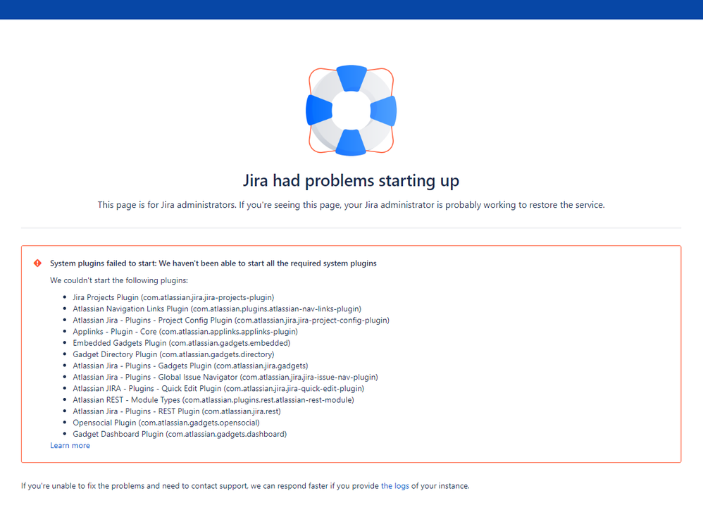

Hi. I have just installed a new fresh copy of Jira 8.22.2 and after installing, I can load up Jira in my browser and click on "I'll set up myself". However, after using the built-in H2 database option to quickly test everything, Jira gets stuck on "Please wait while the database is setup..." and I cannot do anything. Refreshing the page leads to a HTTP 503 error (indicating to me that the service has completely failed).
After about 10 minutes, it comes back however and says that all the plugins have failed to start (as seen below).
System plugins failed to start: We haven't been able to start all the required system plugins
We couldn't start the following plugins:
  • Jira Projects Plugin (com.atlassian.jira.jira-projects-plugin)
  • Atlassian Navigation Links Plugin (com.atlassian.plugins.atlassian-nav-links-plugin)
  • Atlassian Jira - Plugins - Project Config Plugin (com.atlassian.jira.jira-project-config-plugin)
  • Applinks - Plugin - Core (com.atlassian.applinks.applinks-plugin)
  • Embedded Gadgets Plugin (com.atlassian.gadgets.embedded)
  • Gadget Directory Plugin (com.atlassian.gadgets.directory)
  • Atlassian Jira - Plugins - Gadgets Plugin (com.atlassian.jira.gadgets)
  • Atlassian Jira - Plugins - Global Issue Navigator (com.atlassian.jira.jira-issue-nav-plugin)
  • Atlassian JIRA - Plugins - Quick Edit Plugin (com.atlassian.jira.jira-quick-edit-plugin)
  • Atlassian REST - Module Types (com.atlassian.plugins.rest.atlassian-rest-module)
  • Atlassian Jira - Plugins - REST Plugin (com.atlassian.jira.rest)
  • Opensocial Plugin (com.atlassian.gadgets.opensocial)
  • Gadget Dashboard Plugin (com.atlassian.gadgets.dashboard)
When stopping the Windows service, waiting for it to shutdown and then restarting Jira again, it takes another 10 minutes trying to startup where I'm stuck on this loading page for that time.
Eventually it then shows the failed plugin screen again (same info in the list above).
I have tried deleting .bundled-plugins and .osgi-plugins as other users have mentioned the plugins can become corrupted (even though this is literally a fresh installation) but the same issue persists.
I have restarted my Windows Server and I am running the latest updates from Microsoft. The server is Windows Server 2019. Windows Defender is disabled and I have the Atlassian directory from Program Files added as an exclusion.
I am very lost as per what's going on. I of course have the logs but they are extremely confusing and I have no idea what is going on. Any help at all would be greatly appreciated as I have been at this for nearly 13 hours now and it's driving me nuts.

Matt May 14, 2022
Workaround
Use Java 8.
Delete "atlassian-authentication-plugin-4.2.6-fork-1.1.0.jar" from "../WEB-INF/atlassian-bundled-plugins/".
Bug reported to Atlassian from ticket PSSRV-40683 for further review
https://jira.atlassian.com/browse/MIG-740

Matt May 14, 2022
As mentioned twice, that is not the issue.
I am now trying to change Java versions from the built-in version included with 8.22.2 to "Java SE Development Kit 8u202" (64-bit) which I have manually installed.
https://jira.atlassian.com/browse/JRASERVER-73257
