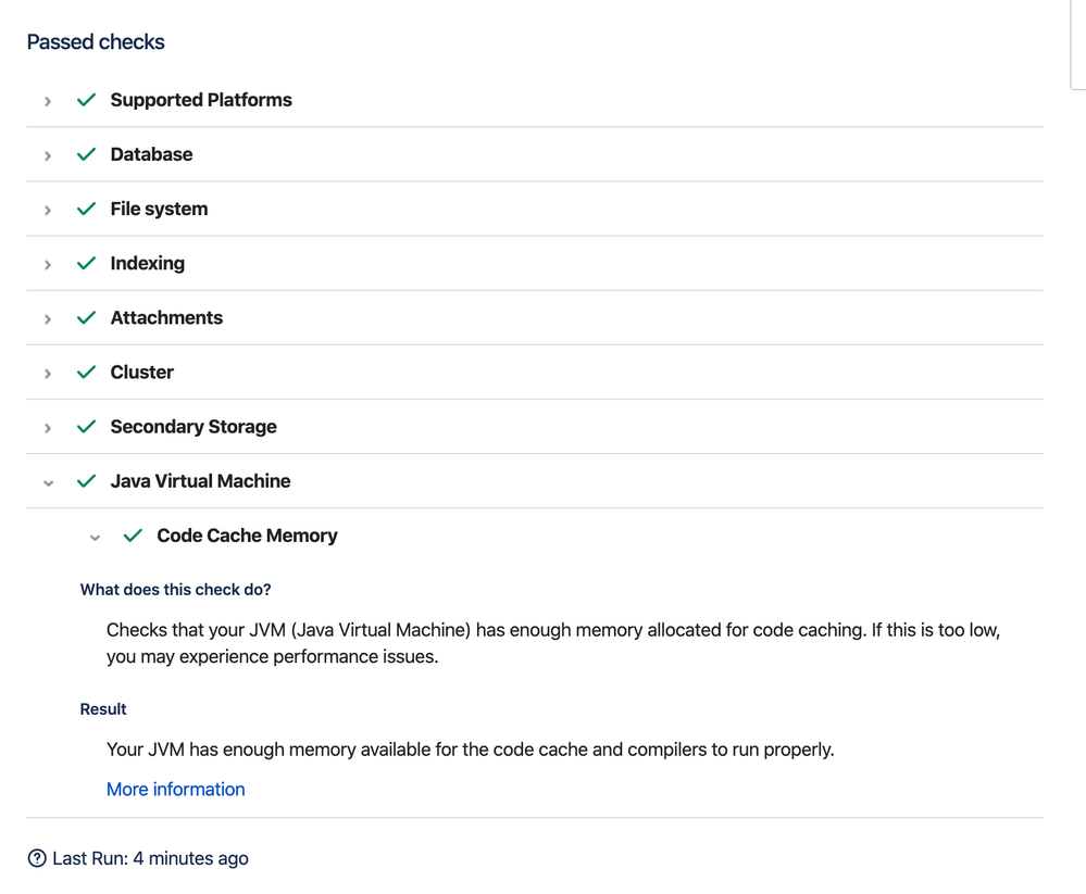

Go to the manage apps page on your Jira Instance and confirm that there is no update available for ATST. If there is, update it. I might get updated to another version of 1.23.1
Once you have done that, you should see the Code Cache Memory health check at the Troubleshooting and support tools page under the Java Virtual Machine section.
Adrian Stephen
January 23, 2020

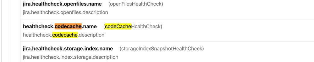

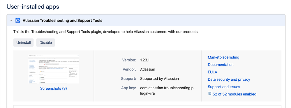

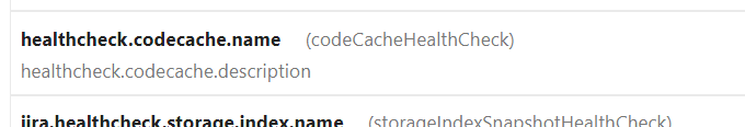

Can you go to the manage apps page in Jira, expand Atlassian Troubleshooting and Support Tools > expand the modules ( you should see 52 of 52 modules enabled ) and search for "codecache". Are you able to see this module?
Screenshot 2020-01-24 at 1.03.02 AM.pngScreenshot 2020-01-24 at 1.03.09 AM.png

If you do not see the module healthcheck.codecache.name, could you try downloading and uploading the 1.23.1 version for Jira Data Center 7.4.3 - 8.6.1 from https://marketplace.atlassian.com/apps/1217696/troubleshooting-and-support-jira/version-history because this feature works on my end as the screenshot above.
