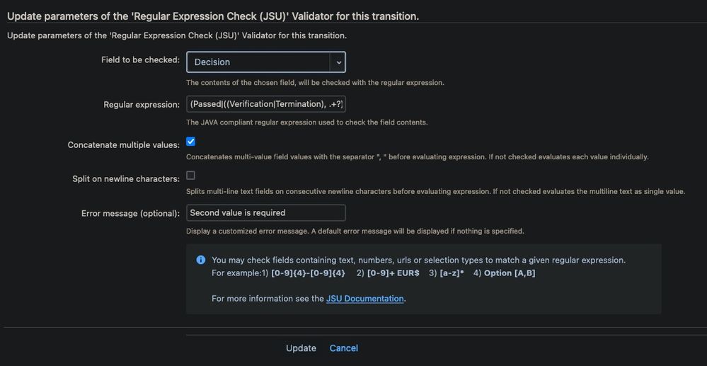

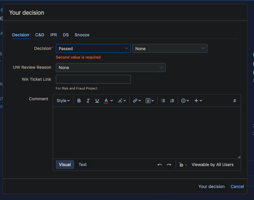

schneurk
August 31, 2022
I tried this logic as well but it's not working.
For example:
Field is Decision and Regular expression is (Passed|((Verification|Termination), .+?))
When Passed is selected and no child is selected, error is thrown.
Any ideas?
