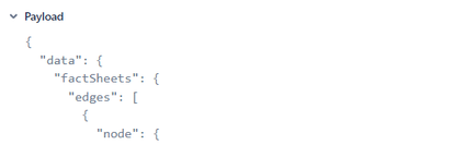

I am creating an automation rule on Jira that sends a POST request to an external API and the response is stored in a text field. Now the problem I have is that the JSON format is changed when I try to access the body via {{webhookResponse.body}}.
Also, I see the proper JSON format when I try to validate the rule manually before deploying it. I am aware that the automation formats the response so that the JSON values can be accessible via dot notation. But is there a way to access the raw response?
I also have a scriptrunner plugin which I can utilize.
Payload:
webhookResponse.body:
I somehow need that data as show in the Payload format since I am using it for processing data for other requirements.

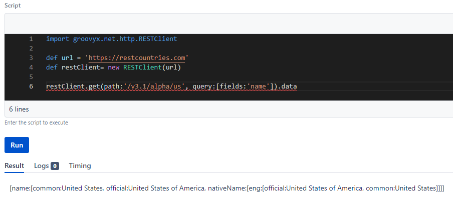

Here is a better example than google (which isn't an api)
I don't know why this would just spin on your end. Does your server have outgoing internet access?

The RESTClient automatically converts the JSON string into an actual object.
If you only need to work with the underlying data, it's best to keep it as the object. Then you can easily access various elements.
In my example from above, you could do something like this:
import groovyx.net.http.RESTClient
def url = 'https://restcountries.com'
def restClient = new RESTClient(url)
def response = restClient.get(path:'/v3.1/alpha/us', query:[fields:'name']).data
response.name.common
