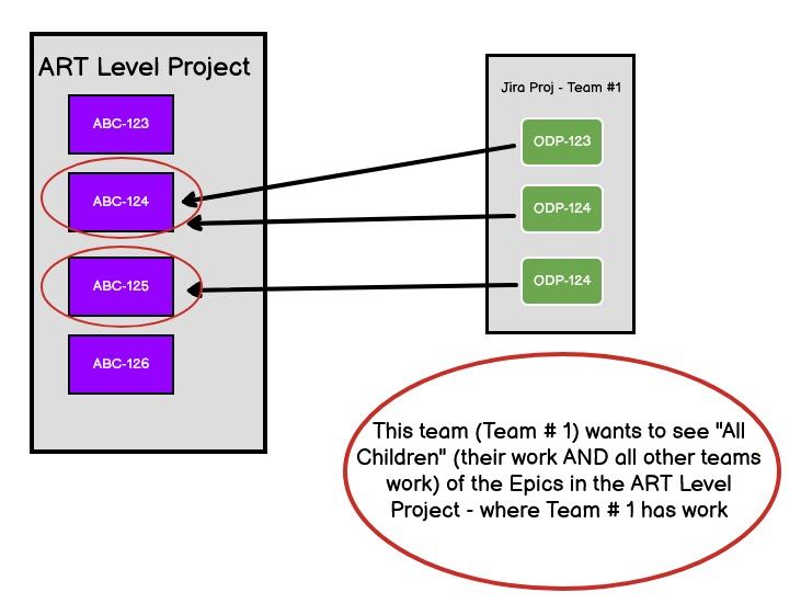

We have ART level Jira projects (with only Epic issue types) and team level Jira projects (with Story level issue types)
Team #1 Wants to see all of their features and stories (This is not a problem) BUT - they would also like to see all of the stories (from other jira projects) also in those epics/features.  Can anyone assist with the JQL for that?JQL Logic help.jpg

Native JQL functionality is not capable of getting you the results you want. It would need to do something like this:
Filter 1: The stories from ODP that have a parent Epic in ART
Filter 2: All the children of Epics identified by Filter 1
example:
issue in childrenOf( parentEpicsOf(project=ODF) and project=ART)
This can be supported only with the help of third party apps that extend JQL capabilities. Some of the apps listed here include the required functionality. Do you have any of these apps on your Jira instance?

Then you should be able to construct this query in Enhanced Search to get the Epics of the issues in the ODF project where the Epics exist in the ART project.
issueFunction in epicsOf("project=ODF") and project=ART
 Save that filter.
Then construct a second filter to retrieve the child issues of the Epics from the first filter:
issueFunction in issuesInEpics("filter = 'name of first saved filter' ")
However I have just tried using the issuesInEpics function in my own system and it is not currently returning any results. I have posted my own Question to ask if others are also experiencing that.
https://community.atlassian.com/t5/Jira-Software-questions/Scriptrunner-issuesInEpics-returns-no-results/qaq-p/2441179
There have been some changes being rolled out that will eventually deprecate the use of Epic Link, which the Scriptrunner function may depend on, but the Epic Link data does still seem to be present.
Try the above for yourself and let us know if you get results for the second filter.
