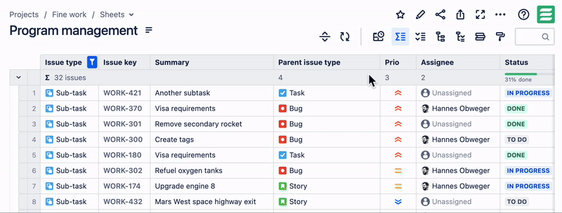

Just to expand on the last point, this is how this would look in the app that my team and I are working on, JXL for Jira:
For context, JXL is a full-fledged spreadsheet/table view for your issues that allows viewing, inline-editing, sorting, and filtering by all your issue fields, much like you’d do in e.g. Excel or Google Sheets. It also comes with a number of so-called smart columns that aren’t natively available, including the parent issue type.
As you can see above, you can easily sort and filter by the parent issue type, and also use it across JXL's advanced features, such as support for (configurable) issue hierarchies, issue grouping by any issue field(s), sum-ups, or conditional formatting.
