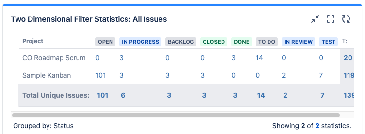

If you wanted to reduce the issue search list so that you could see a concise list of the projects rather than each issue then you could do something like use the Two Dimensional Filter Statistics gadget on a Jira Dashboard to organize the issue search results into a table of issue counts across Projects and issue statuses.

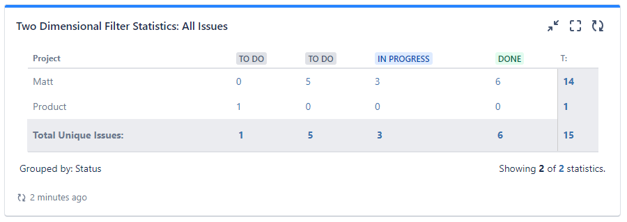

I do have a question related to that 2d issue gadget you showed. I created one of my own and I'm seeing two "To Do" status columns, one from each of the two projects.
By chance have you see this before, or might you have an idea as to why it happened? We have not customized our statuses at all. The projects are basically bare bones.

Are you using Team Managed projects in your instance? If so, the Statuses in the workflows are each considered a unique Status value with a unique numeric ID in the database, even if the human readable name of the Status is identical to a Status in another project's workflow
Matt Richards
May 17, 2023
Yup, that's it. Darn.
