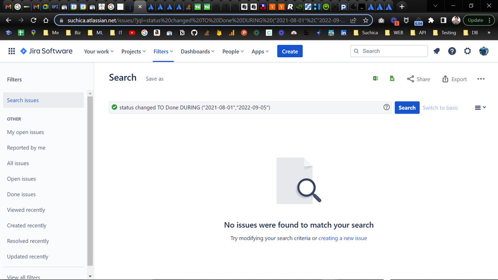

As title says, I can not get any results by using JQL like
All JQL does not work. But I have surely these tickets whose status changed to done after 1st August.

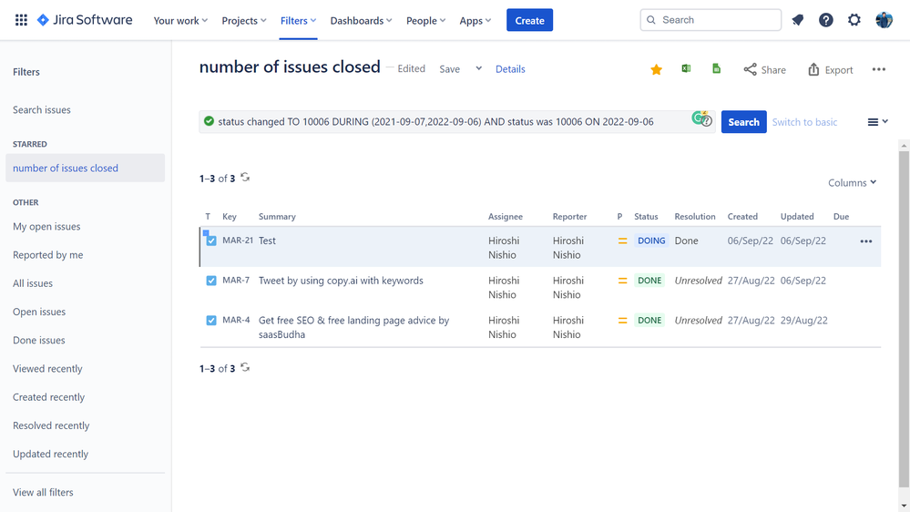

Not a very direct solution, but I solved it by using status id instead of status name. For example, "Done" was "10006" for me.
It looks like the problem is that the names don't match, but it looks like they do, so I'm out of luck.
The important thing is that it doesn't matter if it is a name or an id, I hope this is the same for all users, and Done is 10006.
Status name is "Done" as a default, whose status id is 10006 for all jira users??
Thank you for sharing your solution @Hiroshi Nishio

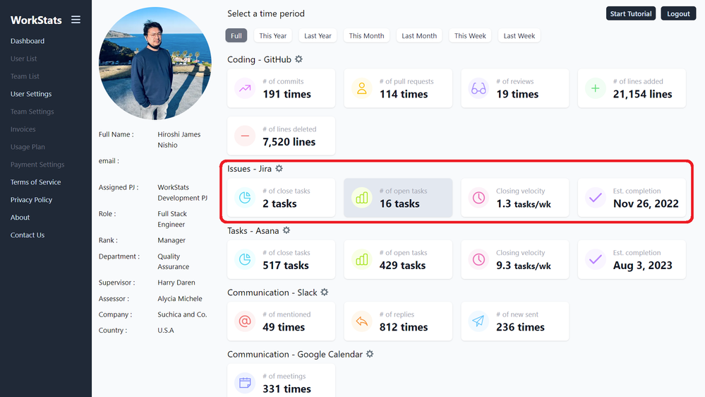

Exactly, I would like to know "Done" as meaning, not "Done" as a string, so maybe status = Resolved and Closed should be treated equally as Done. I am developing an aggregate dashboard (https://workstats.dev/) like the one attached, so I am not the only one who will be using it, but an unspecified number of users.

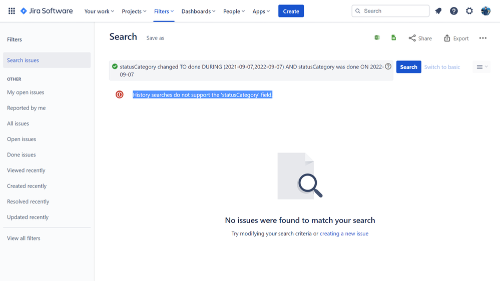

Unfortunately, the error occurred and says "History searches do not support the 'statusCategory' field."
Ah, I didn't think about that.

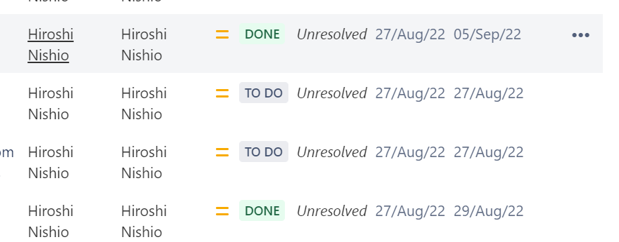

Just, please look at lines 2 and 3. By default, it looks like the resolutiondate is still "unresolved".
The first line is resolved, but this is resolved because it was intentionally set to be resolved when the status = Done in the Automation settings. However, there is also the problem that even if the status is changed from Done to Doing, it remains Resolved.
Yeah, I know. This can happen.
Ideally your workflow is configured that way that when an issue is transitioned to an end state, the resolution is set (via a screen or a post-function) and when you move it out of an end state you would clear it again via a post-function.
But this is not the case for all project setups.

I've verified your JQL statements on my instance and they work properly.
status changed TO "Done" AFTER "2017-11-28"

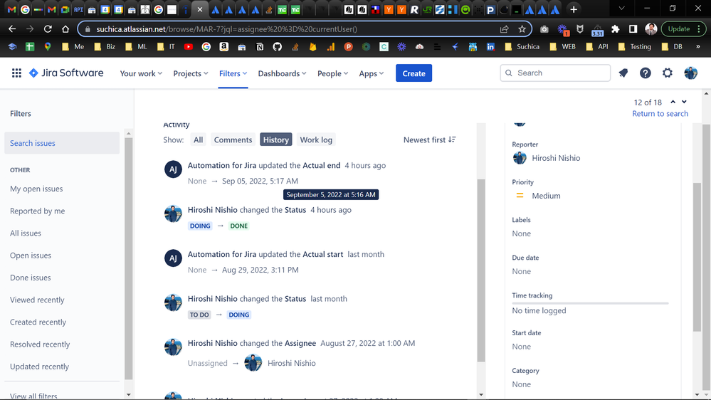

What a surprise. So it doesn't seem to be a problem with the JQL itself. Hmmm, I'll check my ticket.
Doublechecked my ticket and still, it seems I changed this ticket status from Doing to Done 4 hours ago, which is Sep 5, 2022. So it means my JQL should include at least this ticket but does not.
I agree, @Hiroshi Nishio. But I'm afraid, I can give you any other tips. I'll ping some others for advice.

This JQL also works on my side. Can you double-check the "Done" status? Sometimes there is a space hidden somewhere (like " Done" or "Done "). You can use the basic search to select the status you need and then switch to advanced search.
Other than that, you can also try similar JQL queries like:
status changed to Done during (2021-08-01,2022-09-05)
Hope this helps,
- Manon
I know what you mean, and double-checked it, but "Done" was actually "Done" because it was created by Atlassian as a default instead of me.
I will try the similar JQL you gave me.
@Manon Soubies-Camy @Matthias Gaiser _K15t_
Unfortunately... it did not work.
