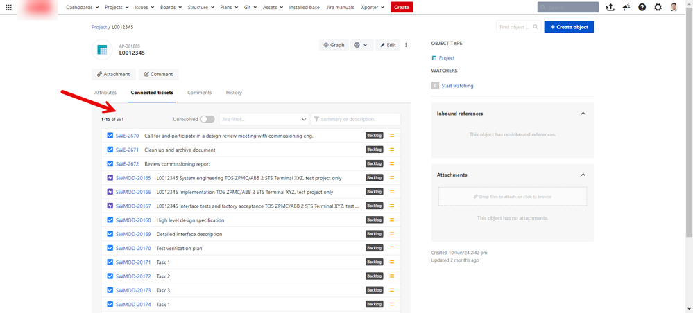

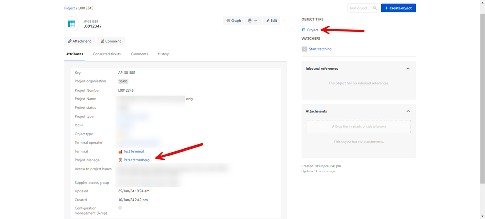

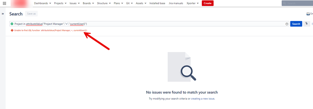

Peter Strömberg
August 12, 2024
Thanks Lisa,
Perhaps getting closer, but still generating error.
I enclose some pictures showing the object, attribute, and search result.
Lisa Forstberg
August 13, 2024
Oh I think I made a couple of mistake here.
1) attributeValue is deprecated,  we should use aqlFunction instead
2) If we run
Project in attributeValue("Project Manager","=","currentUser()")
then Jira will look for the the Jira Project, not the field called project.
You have a asset custom field called "project" right? that is applied to each issue connecting them to the project object. If you find the custom field id for that field you should replace it with  12345 in this example:
cf[12345] in aqlfunction('"Project Manager"= currentUser()')

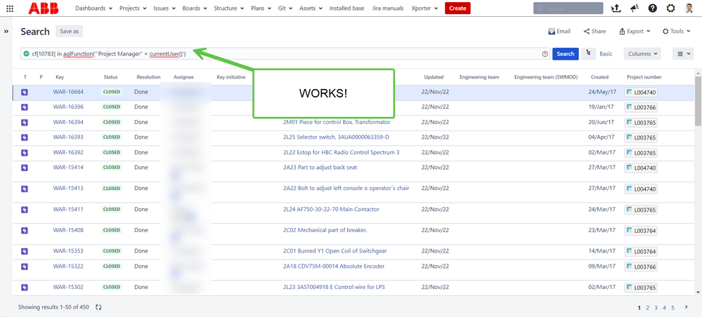

Peter Strömberg
August 13, 2024
Thanks a lot Lisa!
It finally worked!! :)
I used this search string: cf[10783] in aqlFunction('"Project Manager" = currentUser()')
See screenshot.
This opens for a lot of new possibilities in building Structures, dashboards and searching issues. Issue resolved.
