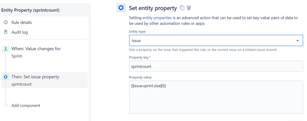

meerm
June 28, 2023
Hi @Bill Sheboy
I have created an automation for assigning the entity value as "sprintcount".
Although the value is getting set and I am able to access the value in automation by populating it in comments or assigning through smart value, but when I am trying to access using JQL query as
issue.property[issuecount] > 1
I am not getting any value. Is there anything I am missing
Bill Sheboy
June 29, 2023
I note your JQL is referencing issuecount but your new entity property key is named sprintcount.
Even with that change, I also am not able to get this to work with JQL, and cannot find my earlier saved examples.  It appears I used the entity property manager (free marketplace addon) to originally get the field searchable.  Although that would open this up globally for changes due to a defect in the addon.
At this point, I recommend either:
  • using the custom field or
  • using a scheduled rule which generates a periodic report for issues in more than one sprint.  The same counting technique I noted earlier could be used with the Lookup Issues action to do that.

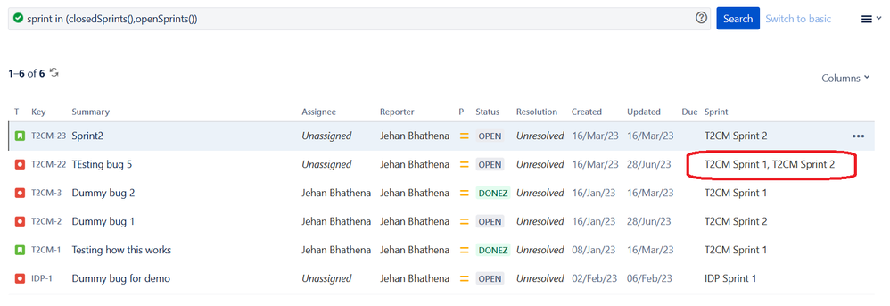

Jehan Bhathena
June 28, 2023
Hi @meerm ,
Below was an attempt I took at your use case,
"T2CM Sprint 1" is closed, while "T2CM Sprint 2" is open. Are you looking for the issues like the one I have highlighted or is it some other scenario that you are looking for.
meerm
June 28, 2023
Hi @Jehan Bhathena
Thanks for your response.
Yes I am getting the results using this query, but I also need to list issues having two closed sprints and not in open sprint.
Like Jehan Bhathena likes this
