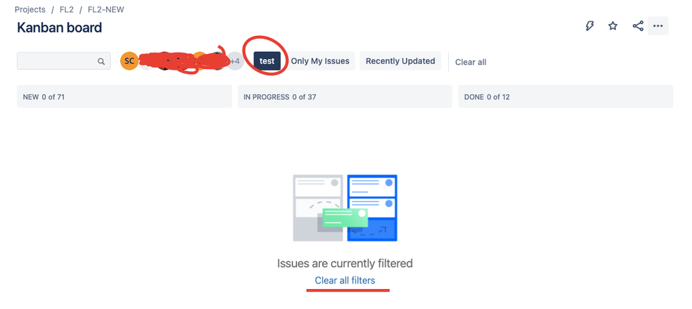

This filter works when I go to "Filter" and then in "advanced search issue", but I wanted to add this filter in my Kanban board as a "quick filter", and I used exactly the same query, but then It doesn't display any issue.
Why does It happen?

The thing about quick filters (and Kanban board sub-filters) is they add onto the existing board filter; they do not replace it.  So the issues may have already been excluded by the board filter.
One possible work-around is to make your board filter less specific, and then use the quick filters to limit what is shown.
Please note: if your team is using the current board, you may not want to change the filter.  Instead, consider if you should create an additional Kanban board just for this type of reporting/analysis.
