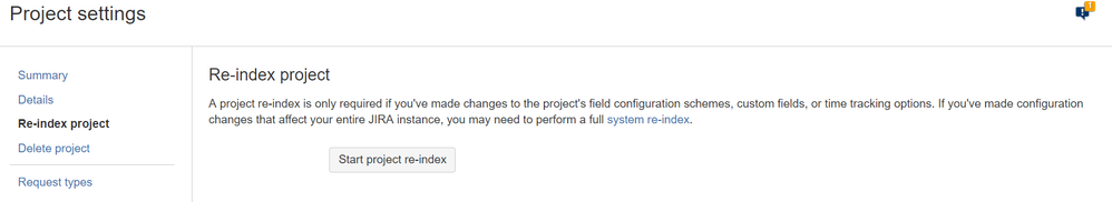

@Jose Ramirez Did you try to re-index the project? There's a "Re-index project" button that solved a similar problem i faced
To elaborate, I recently added a custom field, and had to retroactively populate the field with data for issues. So when I scan for project=ABC AND custom field = EMPTY for a particular issue type, it has nothing, and returns nothing, obviously. The system knows nothing of the newly added field. I have to "JQL it" using only "project=ABC AND issuetype = XYZ" and then add the new field column on the issue listing, and order it so I can see the empty field for older issues, and then bulk change with a script in a post function to perform the retro mapping. It would have been great had the system recognized the 'emptiness' of the new field, but that would require a system re-index, and who has time for that ?

Use "Re-index project" to solve this issue once and for all
