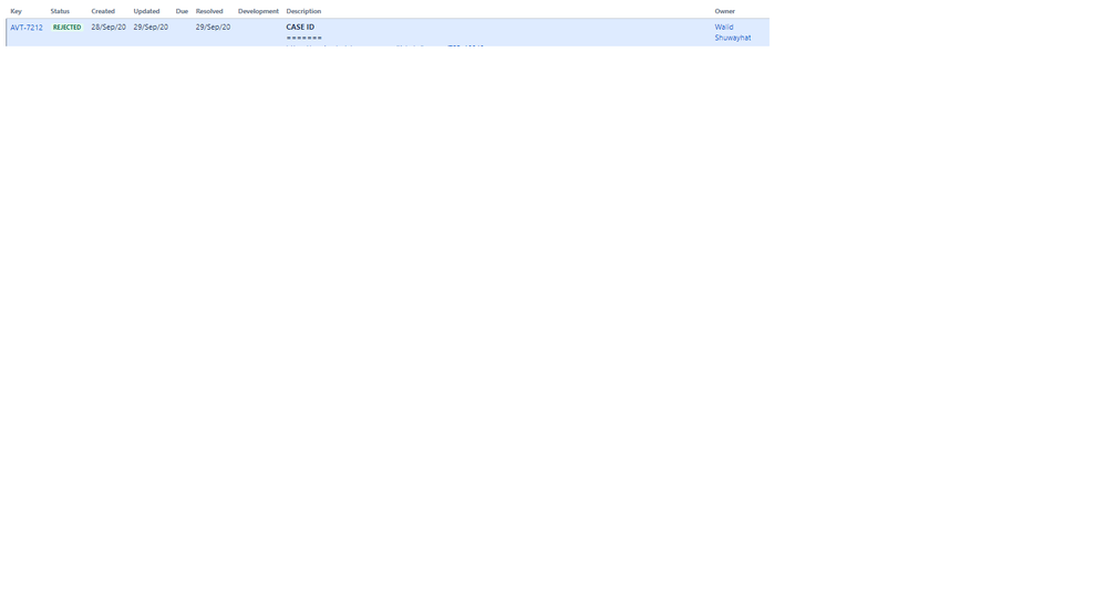

Shaik Moid Ahmed
October 5, 2020
Hi Nic
Even though there is value in Owner field its treating as Empty.
