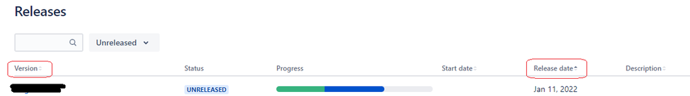

In the releases view we see in the table a column of the fixVersion, and also the column of "Release date".
How can I get the value of the "Release date"?

I now suspect it is a custom field. Is it?

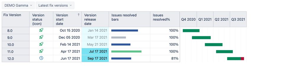

If you are looking at how to make reports about your version release date, you may want to explore the "eazyBI for Jira" app with a native Jira integration.
Here is a demo report for Version releases in the Gantt chart that uses "Version release date": https://eazybi.com/accounts/1000/cubes/Issues/reports/754436-fix-version-release-gantt-chart
