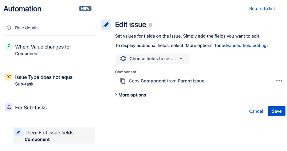

I think Automation is the solution, you can build a rule like this one:
You would just need to replace the field "Component" with your field "Front Back End".

I think this will work, but i work with the free version of Jira. This solution will consume more then the 100 free automation calls. Is there another way to fix this?
Kind regards,
Jeffrey Slootweg.
Manon Soubies-Camy
February 9, 2021
Unfortunately you won't have any other solution than updating manually each sub-task. There is no out-of-the-box JQL query to get an issue and its sub-tasks.
