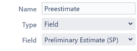

MelvinDave
May 9, 2024
Hey. Yes, I am sure I am using the correct field name, but do I need to use the field instead of the name?Screenshot 2024-05-09 112520.png
Trudy P Claspill
May 9, 2024
I'm not clear where that screen image you provided comes from, but I believe you need to be using the field name (without spaces) as it appears in the Custom Fields screen.
I suspect in this case you would be needing to use "PreliminaryEstimate(SP)".
I think you also need to be using the double equals for the comparison, as @PD Sheehan mentioned.
