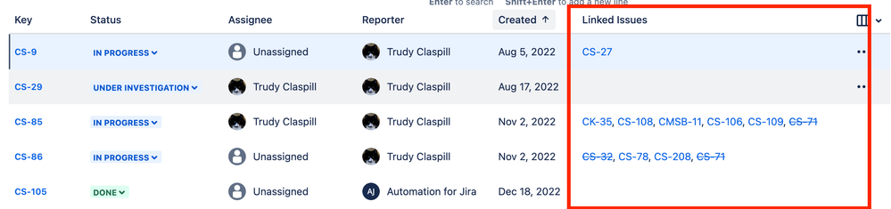

Issues linked to what? Are you trying to retrieve not just the child issues of the Epic, but also the issues linked to those child issues?
If you change the output display from Details to List, you can add the Linked Issues field to the output columns. For each issue you retrieve that column will then show the issue keys of issues linked to it, but no other detail for the linked issues.
