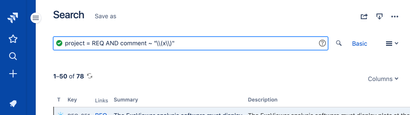

I should mention, I did try it exactly as you suggested with
comment ~ "\\(x\\)"
Which does indeed find a number of issues.  Specifically, the JQL query found 78 of them in the current project:

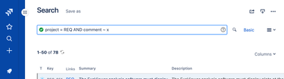

However... i think that's just because the x isn't a special character.  When I search using only
comment ~ x
I still get the same 78 issues:
But when I replace the x with \\! or \\?, i get nothing.
Petter Gonçalves
January 7, 2019
Hello Devon,
Thank you very much for your answer.
Analyzing the information you provided and digging a little bit further in our documentation, I was able to find out that indeed this search is not working as documented in this article.
In fact, the search I've sent to you works because x is not a special character, just like you correctly mentioned. When using special characters, it does not work.
A bug was already raised about this behavior:
JQL queries with special characters returns incorrect results
Our developers have decided to change it to a suggestion and open another suggestion to update our documentation since it is working as designed, although it's not working as documented and as the customers expected.
I understand how this decision may be disappointing to you, Devon.
Please, vote and watch the suggestion above in order to change the search way as documented now, using the // to escape special characters. Also, feel free to give your feedback on that.
For more information about why our developers have decided to raise it as a suggestion and not as a bug, check the report below:
https://jira.atlassian.com/browse/JRASERVER-40790
Please, let me know if this information answers your questions.
