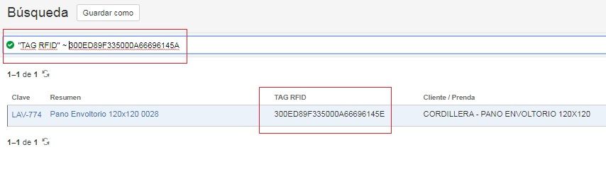

Hi, please, i need your assitance, we are using por RFID Projects..we communicate Handhelds and antenna RFID with JIRA.
In asepco.msys.cl, we are working with a laundry system..where each issue is a clothe..
For each issue existe a custom field called TAG RFID equal to EPC CODE RFID ( 24 chars ) for each other...
We have problema with search.
i. We make a JQL Search
"TAG RFID" ~ 300ED89F335000A66696145A
And return this register.
LAV-774
Pano Envoltorio 120x120 0028
300ED89F335000A66696145E CORDILLERA - PANO ENVOLTORIO 120X120
As you see the search is not correct..
However if i search..
"TAG RFID" ~ 300ED89F335000A66696145A* or
"TAG RFID" ~ '300ED89F335000A66696145A*'
works fine..
Another thing..the search works fine also with TAG RFID with another header..por sample E200D89F335000A66696145A, why?
I hope can you help us..Thanks!

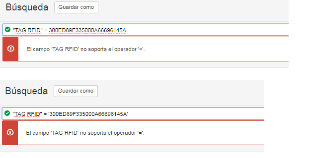

Andrej Freeze greenique
November 18, 2019
Hello @Alfredo Servat , have you tried to perform a search with a "=" instead of "~" ?

asepco_jira.jpgAs you see the Search result is incorrect!!
