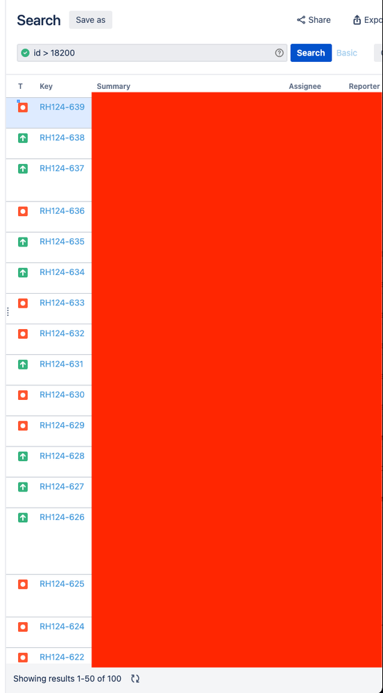

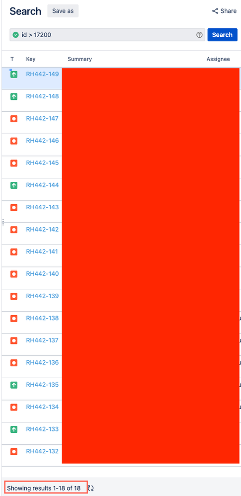

Appreciate the reponse. Why does the JQL search results look like this? First image looks for ids of a lower id number but returns fewer results AND all of the results are always limited to a single project.Screen Shot 2021-12-16 at 9.45.10 AM.pngScreen Shot 2021-12-16 at 9.45.22 AM.png

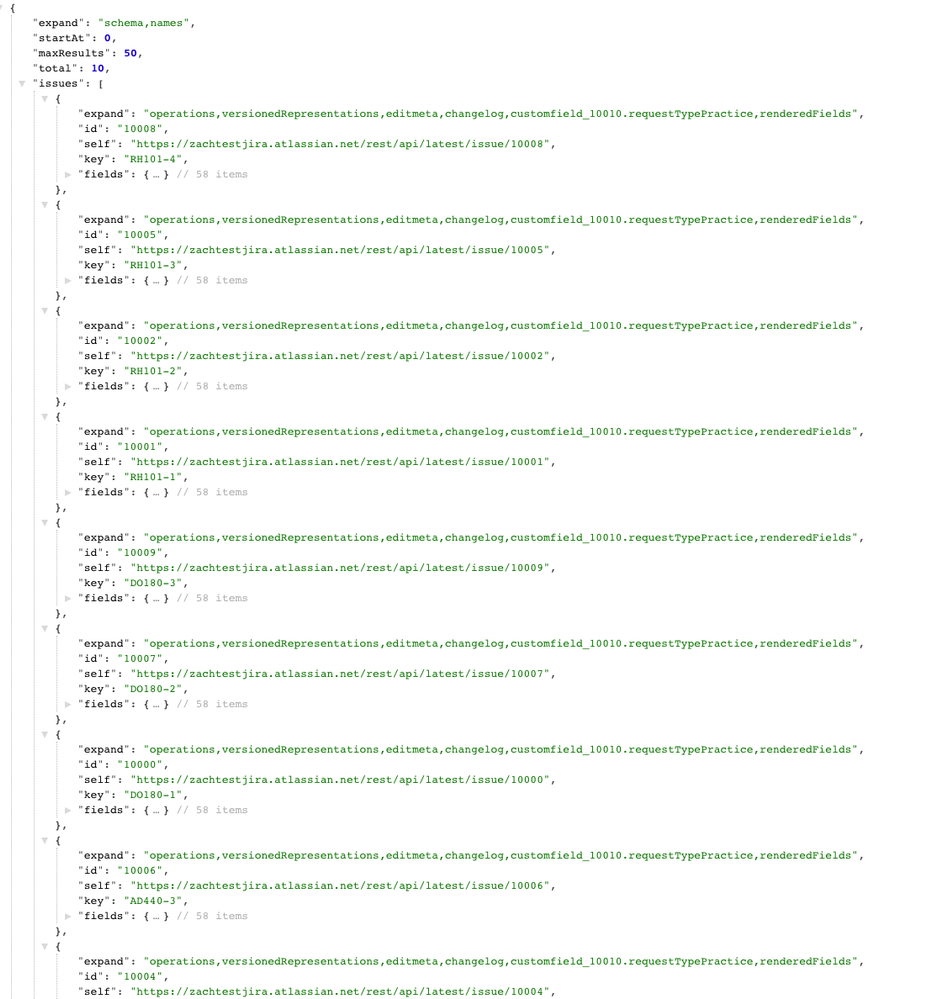

Another example of this issue is hitting the following endpoint (this time i'm testing on JIRA cloud and seeing the same problem):
/rest/api/latest/search?jql=ORDER+BY+id+desc
And getting the following results. You can see that the ids are not returned in order.Screen Shot 2021-12-16 at 10.52.10 AM.png

It looks to me that sorting by id actually is sorting by key perhaps?

First,  your queries are for "ID >", which is simply going to return a list of issues created since an unknown point in time.
Your report specifies no order, so the issue navigator is defaulting to sorting by the issue key.
The search and the report are separate things (although there is some crossover - you can put "order by" in a filter, and some reports, such as the navigator, will sort the results by it)

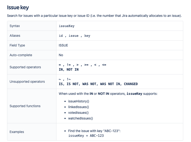

If I set an order (such as Order by id) i still get the same result. Looking at the docs, it appears that id = key when it is being used with jql.

I think the ID order actually IS correct. What doesn't work is that jql does not actually search by the issue id when you ask it to. It is using id as an alias for key and therefore only searching by key issues. If i'm understanding this correctly, jql doesn't actually support searches by id Screen Shot 2021-12-16 at 11.42.32 AM.png
