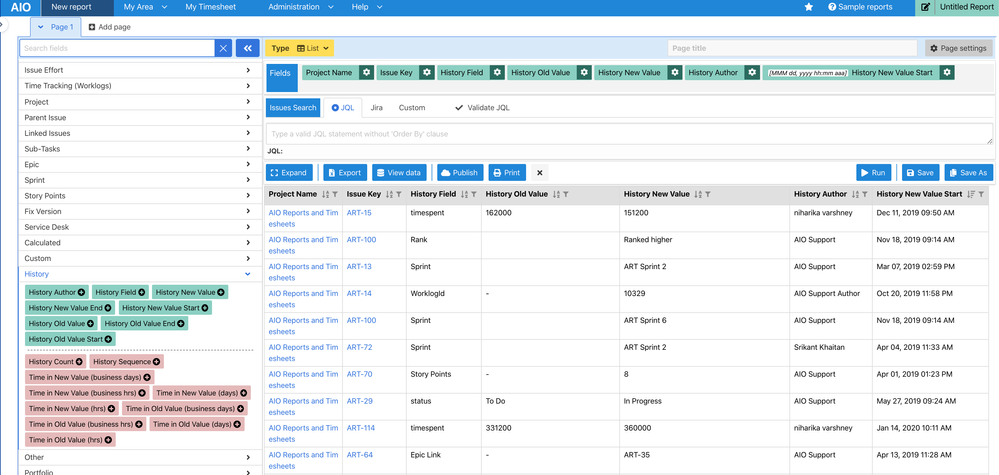

Thanks for the quick response, Kian.
Since I'm new to JIRA and not a person with IT background, I'm not sure how to answer your question.
However, what I would like to see, for reporting purposes, would be a table in where I could find for each row the history changes. So, for the same issue key, we would have several rows, each row containing data for the columns "Field changed", "Original Value", "New Value" and "Change Date".
Is this somehow possible?
Hi,
This is possible with our app: AIO Reports and Timesheets for Jira
Documentation link:
https://aioreports.atlassian.net/wiki/spaces/ART/overview
A sample screenshot is included below.
For any questions or issues, please email us at support@aioreports.com
