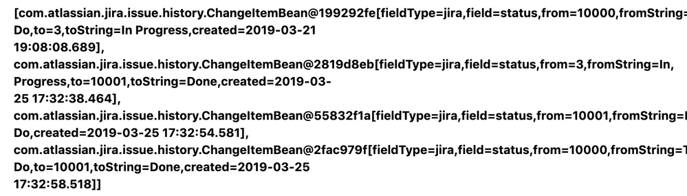

The code on this link is fetching the created date but "getChangeItemsForField" gets all the transitions you are doing on an Issue with multiple entries for each transition. Something like this.
If you look at the output above, there is an entry for "In Progress" with "created=2019-03-21". This is the date when the issue was transitioned to "In Progress". The next item also has a similar date. Calculating the difference will tell you how long that issue was in a specific status.
