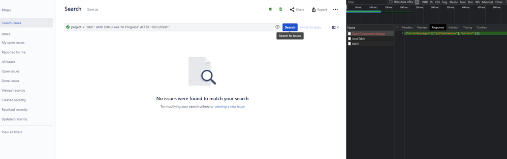

@Jack Brickey I have just noticed the response in the browser =>
https://mvcg.atlassian.net/secure/QueryComponent!Jql.jspa
Response:
Status Code: 400
{"errorMessages":["jqlTooComplex"],"errors":{}}
I guess that is the reason why I get an empty page. I am confused...

@Jack Brickey same error message :(

Wait, are you doing this search in the “Advanced search” screen? Can you share a full screenshot w/ the JQL?
Nikolai Mynkow
September 7, 2021
I am trying from all possible places to execute the query, with project, without project, double quotes, single ones, reverse order, different order by and every time I get the same error:
Jack Brickey
September 7, 2021
So either there is a bug or there simply was not any issues in progress during that date period. It is working fine for me so I don’t really suspect it’s a bug but you never know. From the screenshot it appears to be running successfully as it’s giving you the no issues found message. I would strongly recommend finding a specific issue that you know was in a certain status on certain date. This can be found using the history tab. Then run your search around that condition.
