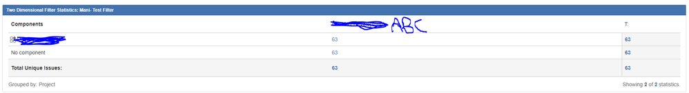

When I manually bulk edit all the 63 issues with a component and create a Two dimensional filter with XAxis = Project and YAxis = Component. I see two entries under components, one with actual component  I assigned to all 63 issues and one with "No Components" with 63 issues and when I click on the 63 issues it takes me to a new page with the above filter with no issues under it.

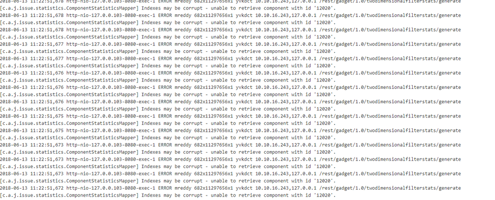

Okay, I found the reason for this behavior by looking at logs.
There is an invalid component associated with the issues, removing the corrupted component fixed it.
