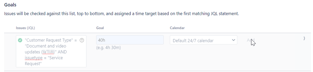

Hi Phil, Thanks for the input. Even I had a similar issue with custom objects in JQL. but without any error, still the Goal is not letting me add it. The hour sign just keep rotating.JQL Goal setup Issue-Service Desk.png

Hi @paras chopra
The first thing I would do is take the JQL and test it in the search page as that gives some error messages rather than just the spinning clock.
Phill
