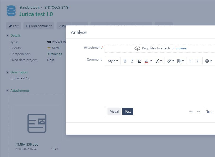

Hi Community,
is this even possible?
When moving from the "open" status to the "in analysis" status, the attachment field should be mandatory, but if at least one has already been added during the "create" process, then no additional entry in this field is required.

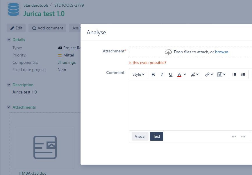

Jurica Petricevic
August 29, 2022
@Marcin Wiktor thx for you time first of all.
Secondly, this does not solve my second part of the problem, where if there is already an attachment, the system ignores this field and releases the transition.
