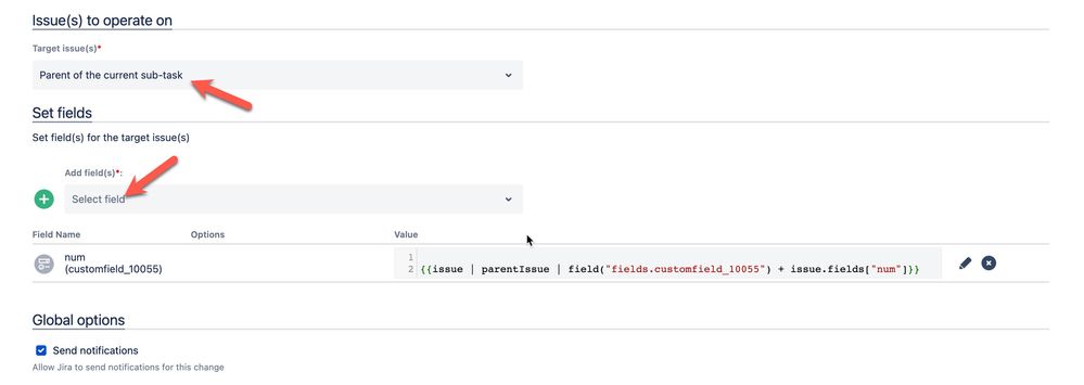

To achieve the desired solution, you can create a  set issue field postfunction on the Complete transition.
then select "Parent of the current subtask" as shown in the below eg:
select the field that you want to update eg: "TOTAL BUDGET"
and then add the below code

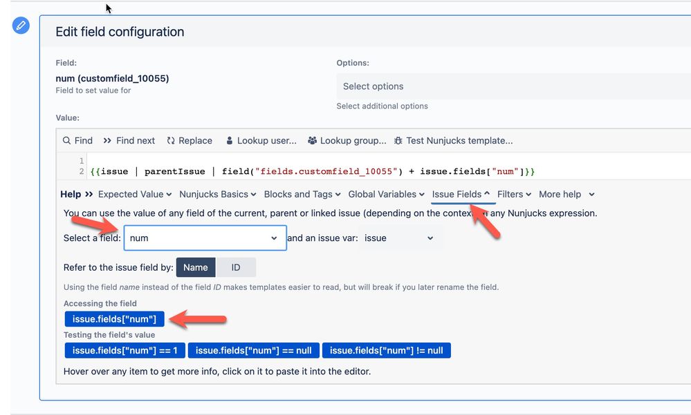

{{issue | parentIssue | field("fields.customfield_10055") + issue.fields["APPROVED BUDGET"]}}
note: Please replace the customfieldId_10055 with the customfield id of field "TOTAL BUDGET" and in place of approved budget, please see the correct format, to get the correct format please see the example below.

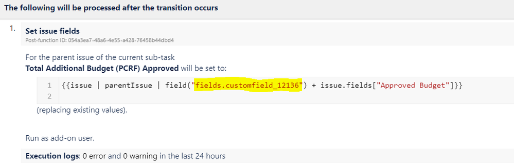

RIZKY JTUASIKAL
October 25, 2023
Hi @Neel Mohapatra _Appfire_ ,
I've tried your suggestion, and it worked well.

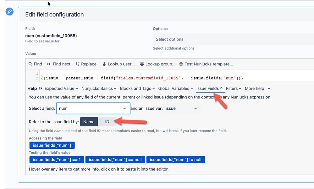

I have one question,
what is the difference when selecting a field with "Name" or "ID"? is there any different functionality between the two?

Hi @RIZKY JTUASIKAL ,
Good to hear that you were able to get it working.
Regarding the diff between ID and Name, There could be two fields with the same name but they are distinguished by customfield id, even in future the field name is changed, the custom field ID remains same.
It is suggested to use the customfield ID instead of the name.
You can get the customfield ID by selecting the ID as shown in the below screenshot.t.jpg
