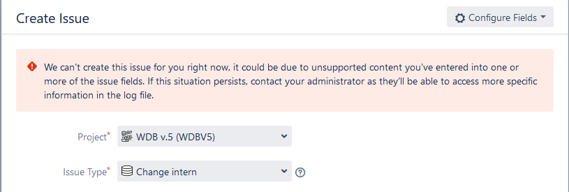

issue.get("issuetype").name != "Change intern" || currentUser.isInGroup("Developers") || currentUser.isInGroup("Administrators")
No, won't work. For some reason I get this message

David Fischer
September 14, 2020
Did you first "test" the Groovy script using the Test Groovy Script button on the Validator configuration page?
You can also check your Jira logs for a detailed error.

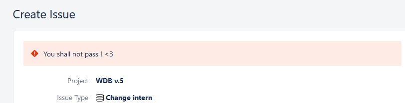

Jurica Petricevic
September 14, 2020
I was just in too much of a hurry. I didn’t save before the test. Great job.
