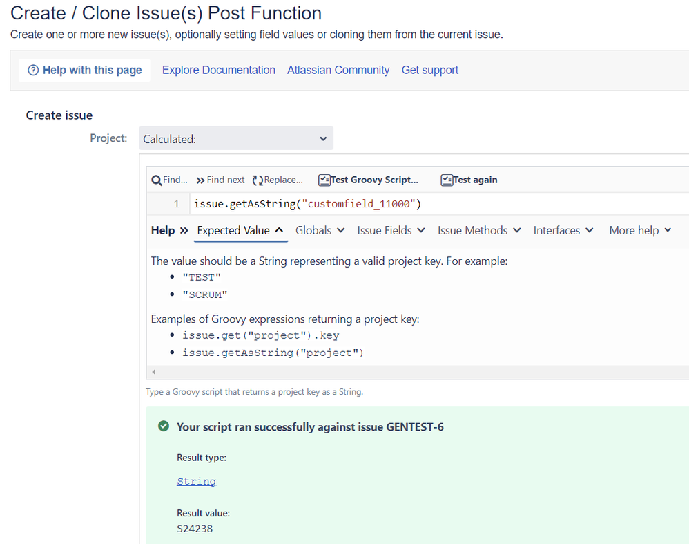

Logged a ticket with the @Appfire Support team who answered the question. Thought i'd repost the answer to let others know !
In JMWE you could use the “Calculated” project option on the Create/Clone Issue(s) post-function. Please refer to the example below:image-20230127-145733.png
In the example above, the custom field type is a project picker. Then you can decide what will trigger the post-function hence the issue copy/clone.
For example, you could use Event Based Actions to execute the post-function once a specific issue field value is changed or when the issue itself is transitioned.
