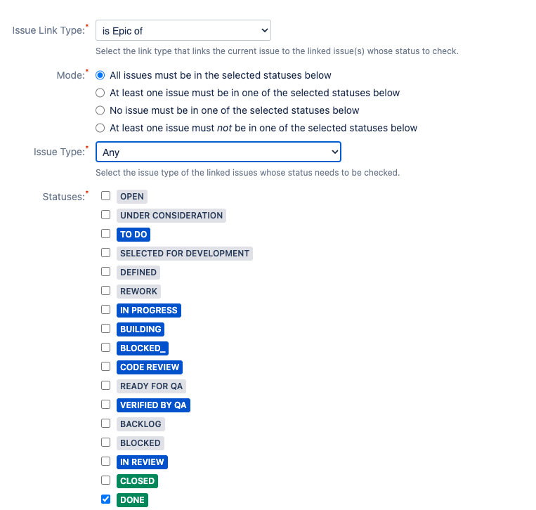

I am trying to configure a workflow transition condition for an Epic where a custom issue type of Test Plan must be Done or Resolved before the Epic can be transitioned.  I model in the JMWE UI fine:

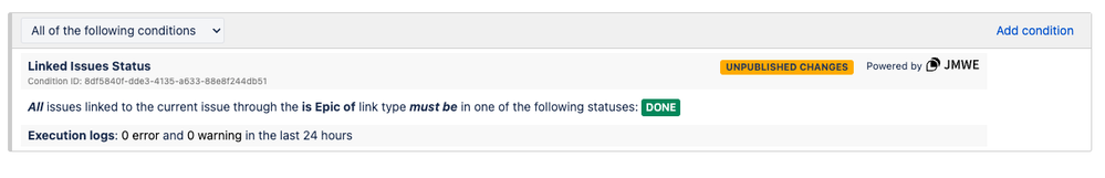

But when I save and go back to the Condition screen it shows the following:
and when I go back in to edit the condition it shows Issue Type of "Any" versus just the type I wanted (Test Plan).
What am I doing wrong?  I tried it with Stories as well to see if it was the custom type but it doesn't work for any type.  How can I get the condition to just evaluate for one issue type?

@Derek Knudsen This isn't a great answer, but I did take a moment to test out your use case and I was able to replicate the issue. So it appears to be a bug. I also tested the identical Validator, and the same issue occurs there.
At this point, I'd recommend navigating to http://appf.re/support or emailing support@appfire.com to submit a support request.
Best of luck!
