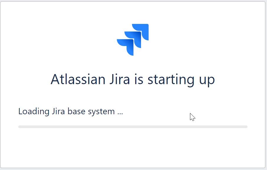

Dear Team,
We are facing issue at JIRA startup.
Does anybody faced this issue and help us to resolve it.

Alexey Matveev
November 5, 2018
Hello,
What is the issue? It means that Jira is loading. If it keeps loading forever, then you should check logs (atlassian-jira.log).
Hemant Kalra
November 5, 2018
 did not find anything in logs
Hemant Kalra
November 5, 2018
Yes.... JIRA is loading forever..
