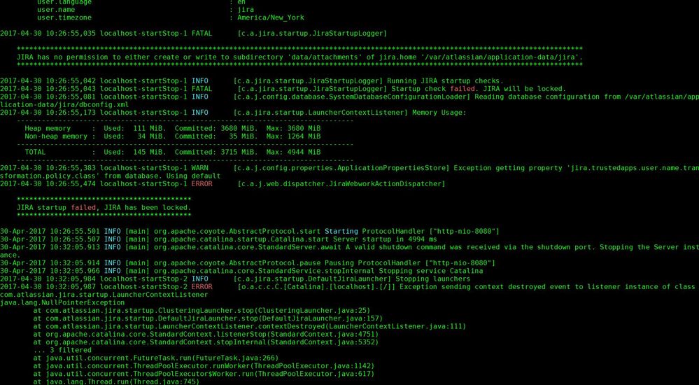

ruudgong
April 30, 2017
[jira@optimus ~]$ tail -100 /data/servers/jira-5.2.11/logs/catalina.out
JIRA has no permission to either create or write to subdirectory 'data/attachments' of jira.home '/var/atlassian/application-data/jira'.

Nic Brough -Adaptavist-
April 30, 2017
You say you've checked the permissions and ownership, but are you sure the user running JIRA is correct?
ruudgong
May 1, 2017
yes, the user is verified.
May 4, 2017
Ok, so the user is jira, the data directory is owned by jira and the owner permissions are rwx, which is correct.
My next guesses are:
1.  SELinux is interfering with file access
2.  Your attachment directory is a remotely mounted file system (NFS or something, so you can store attachments on shared disks to allow for backups or fail-over).  It is possible to have a directory that locally looks accessible, but the permissions on the remote side actually block it.
