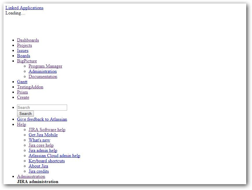

I logged in JIRA site to work on add-on. But the page loads too slow, loading with issues. Have attached the image below after loading. There is no issue in internet speed, I have checked it. Why the page is not loading properly?JIRALoadIssue1.jpg
Nic Brough -Adaptavist-
October 6, 2017
Looks like the css and other resources have not loaded.  Check your network is not blocking things, refresh tthe page, and have a look at the browser's "dev tools" to see what isn't loading and why

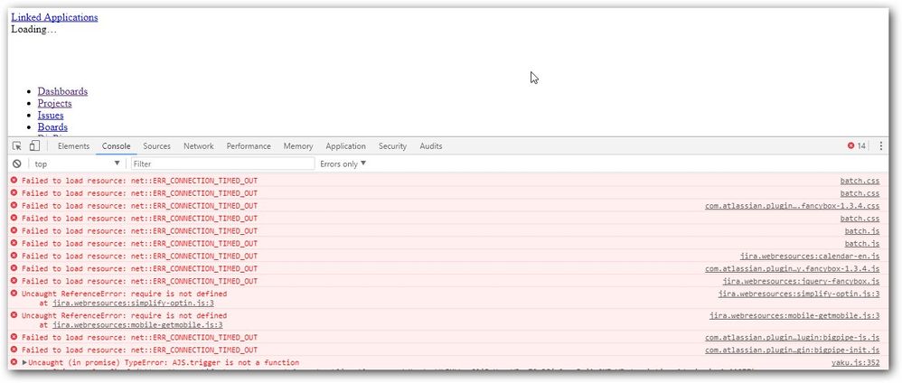

I have cleared browser's cache and loaded again. When referring console, I got error as timed out. Have attached the screenshot below. This issue is not based on internet speed, because other sites are loading faster when compared to this. Also, network does not block any of these things.JIRALoadIssue2.jpg
October 6, 2017
Timeouts like that are either
  • Internet speed (just because one site loads does not mean your route to another is any good)
  • Network blocking
  • Browser or software blocks on your machine
  • Server not delivering content fast enough
The last one could be down to problems with code, a page that's simply too large or the server being slow or overloaded.
