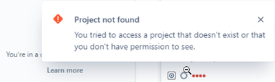

Felix Petsovits
January 26, 2022
Hey all.
Not sure if this is the same issue that you're all experiencing but it might be... sounds at least similar... so here are my findings:
My problem:
I took an old project in JIRA that needed a do-over, renamed it, gave it a new key and also created a new filter that I based my project on. Then I went to the board I created and I saw all the tasks, but I had this notification on the bottom of the board. So far so good.
My colleagues then tried to open the board and couldn't see anything other than this warning:
Alt text:
board not accessible.
It seems this board doesn't have an assigned location. You can ask your board administrator to assing it to a project or user.

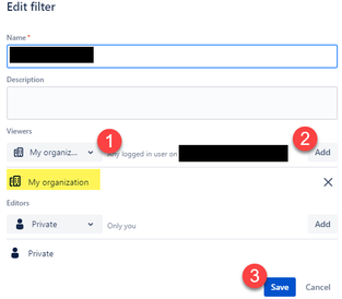

Then I found this thread here and saw that filters might play a role to be able to view the board - most likely because the board is based on the filters. So I looked at my newly created filter for the already previously existing board. In the filter I had only changed the project key, but in the end it was a completely new filter that I used. And I had not given any permissions for it to anyone.
So I went into my filter, I gave the whole organization permission to see the filter (but could probably also be done on an individual level) and everybody was able to see the board.
