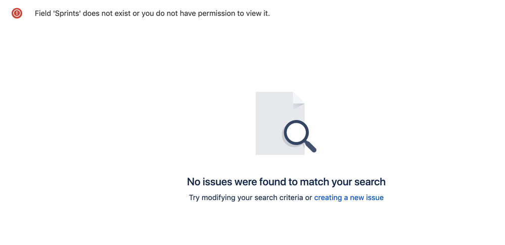

But, when I am using issues in (FET-1234, FET-7383) AND Sprints in openSprints()
I am getting something like this(AttachmentScreenshot 2019-06-24 at 6.58.27 PM.png).
Can you help me out here?
Earl McCutcheon
June 24, 2019
Hi,
The error you are seeing: "Field or Filter does not exist or you do not have permission to view it" has a few different causes covered in the following KB article, and I would guess that the sprint fields is set to Hidden in the field configurations, check out the KB for some additional details at point 5 in the resolution section:

Johan
June 25, 2019
Hi Ayush,
Do you have a custom field called Sprints? If you want the default field, this is a singular form.
So: in the JQL you are using Sprints in openSprints(), where it should be Sprint in openSprints().

Ayush
June 25, 2019
Hi Johan,
No, it is not a custom field and I tried using Singular as well as Plural form but it was not working till yesterday.
Though, it worked with Singular form today. Really don't know how this happened.
Thanks a lot!
