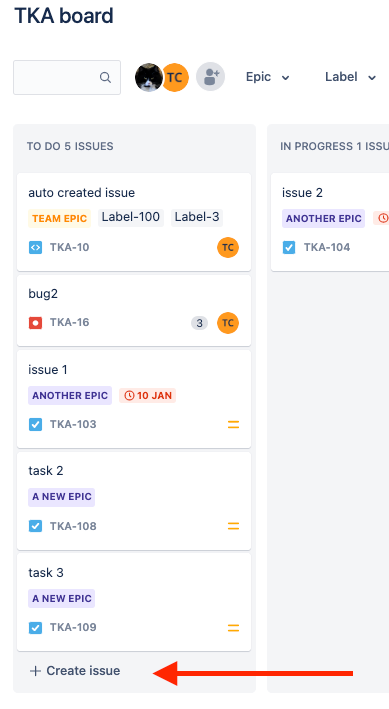

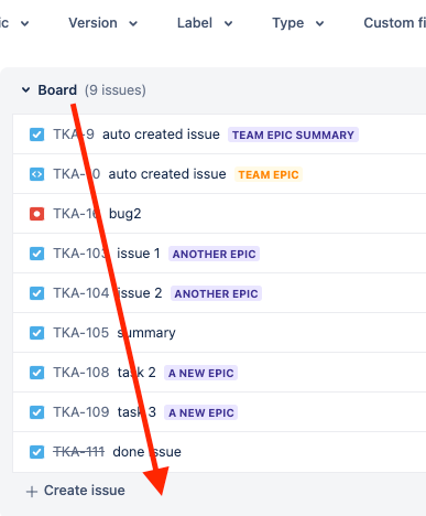

For a Team Managed project to get a newly created issue to display on the board automatically you need to not use the Create button in the menu bar at the top of the screen. Instead you need to use the +Create options that are at the bottom of the left-most column on the board, or at the bottom of the Board section of the Backlog screen.
Screen Shot 2023-05-11 at 10.29.57 AM.pngScreen Shot 2023-05-11 at 10.30.23 AM.png
