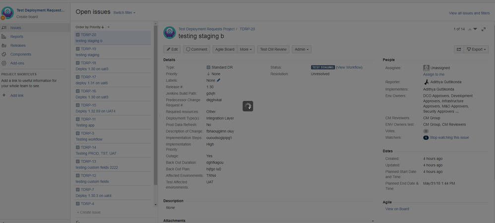

One of my workflows is behaving weird. When I am trying to transition issue from its initial status to next status, it is showing the loading page for ever. I checked the catalina logs but didn't find anything. Please suggest a solution. Thanks in Advance.Transition_loading.PNG

If it's always doing this (that is, it's not a temporary glitch), it would be helpful if you showed what the transition actually does. Does it have a post function that goes on for ever, a strange validator, or something like that?

I have a screen on the transition. When I click on the transition button to perform transition it is not popping up the screen. But, when I open the transition in new tab, new tab is opened with the screen I have on the transition and there i am able to do the transition.
