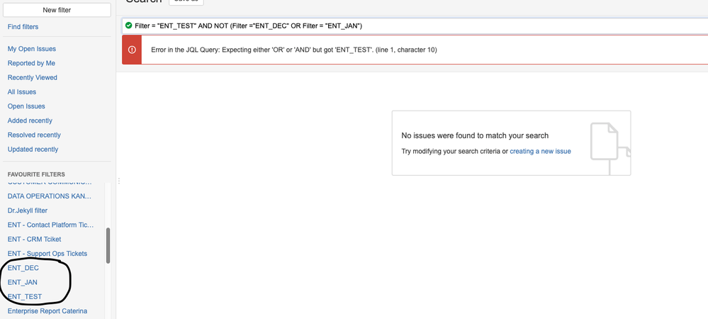

I've saved 3 filters:
1 - project = ENT AND component = "02 - NETWORK" AND created >= 2018-12-01 AND created <= 2018-12-31 ORDER BY created ASC, updated DESC
2 - project  = ENT AND component = "02 - NETWORK" AND created >= 2018-01-01 AND created <= 2018-01-31 ORDER BY created ASC, updated DESC
3 - project = ENT AND component = "02 - NETWORK" AND created >= 2018-01-01 AND created <= 2018-12-31 ORDER BY created ASC, updated DESC
Below the result :(
I'm doing anything wrong :(
Thanks for your patience!!
Mario Carabelli
January 22, 2019

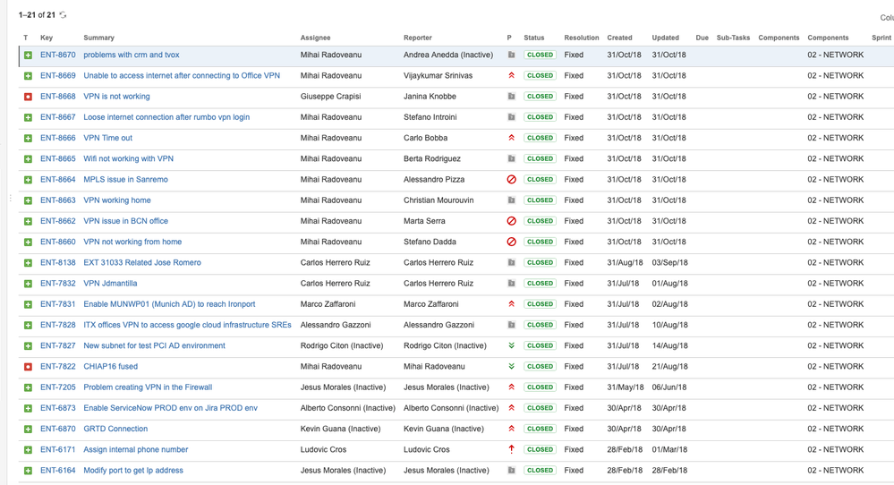

January 22, 2019
HI @Mario Carabelli,
don't worry :)
ok now with your query I found out the 21 ticket missing.
Are all tickets of the last day of the month.. but why happen if in the query I type <= ??
project = ENT AND component = "02 - NETWORK" AND created >= 2018-06-01 AND created <= 2018-06-30 ORDER BY created ASC, updated DESC
Thanks as usual for your help
Nunzio
January 22, 2019
Ok I've understood the problem!
I've to put also the time!!
With this filter: created >= 2018-06-01 AND created <= 2018-06-30" the filter take everything from 06/01 12:00AM to 06/30 12:00AM.
That will miss all issues created on 06/30 after 12:00AM !!!
