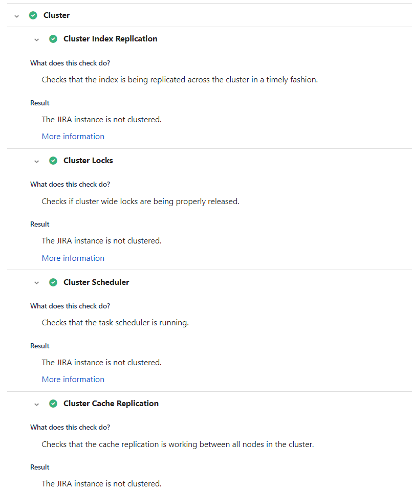

I installed jira datacenter following the official guide, after added second node, when I access the jira from URL,  I can see the "system Info" shows that the clustering in off.

and the support page show node is not clustered
Can anyone help with this setting?

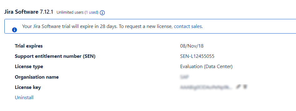

After applying the cluster.properties file on the first node, were you prompted to install a Jira Data Centre license?
Jennings Liu
October 10, 2018
Hi Daniel,
Yes,  you can see the license details.  and I had restarted jira service several times. Snipaste_2018-10-11_09-25-28.png

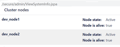

  3. Restart the service
  4. Check the system info and confirm that it is now clustering:image.png
